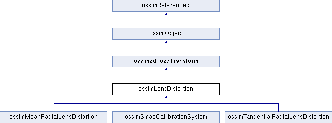

Inheritance diagram for ossimLensDistortion:
ossim2dTo2dTransform ossimObject ossimReferenced ossimMeanRadialLensDistortion ossimSmacCallibrationSystem ossimTangentialRadialLensDistortion
