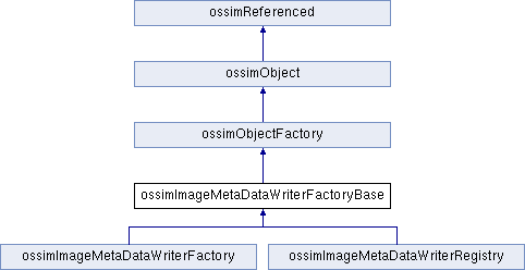

Inheritance diagram for ossimImageMetaDataWriterFactoryBase:
ossimObjectFactory ossimObject ossimReferenced ossimImageMetaDataWriterFactory ossimImageMetaDataWriterRegistry
