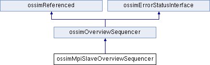

Inheritance diagram for ossimMpiSlaveOverviewSequencer:
ossimOverviewSequencer ossimReferenced ossimErrorStatusInterface
