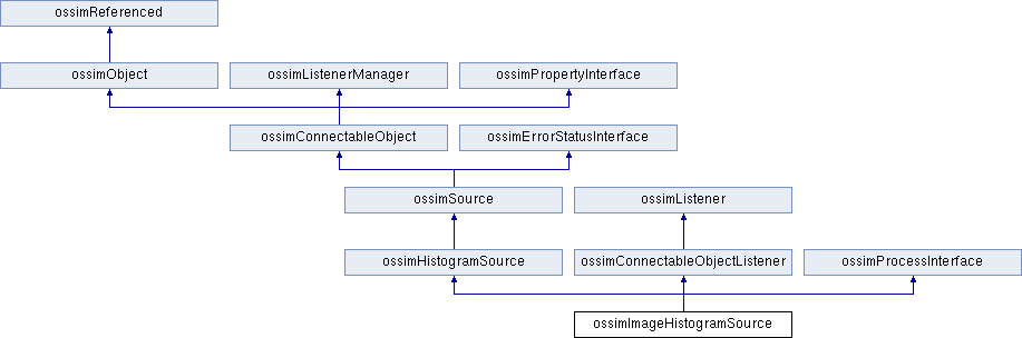

Inheritance diagram for ossimImageHistogramSource:
ossimHistogramSource ossimConnectableObjectListener ossimProcessInterface ossimSource ossimListener ossimConnectableObject ossimErrorStatusInterface ossimObject ossimListenerManager ossimPropertyInterface ossimReferenced
