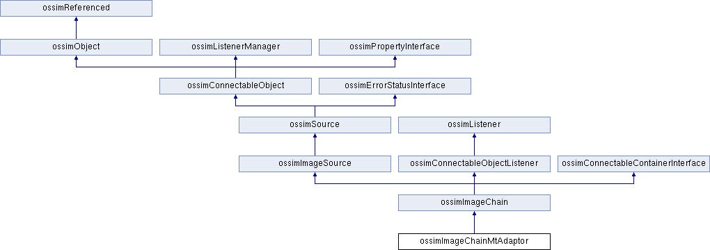

Inheritance diagram for ossimImageChainMtAdaptor:
ossimImageChain ossimImageSource ossimConnectableObjectListener ossimConnectableContainerInterface ossimSource ossimListener ossimConnectableObject ossimErrorStatusInterface ossimObject ossimListenerManager ossimPropertyInterface ossimReferenced
