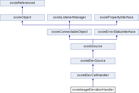

Inheritance diagram for ossimImageElevationHandler:
ossimElevCellHandler ossimElevSource ossimSource ossimConnectableObject ossimErrorStatusInterface ossimObject ossimListenerManager ossimPropertyInterface ossimReferenced
