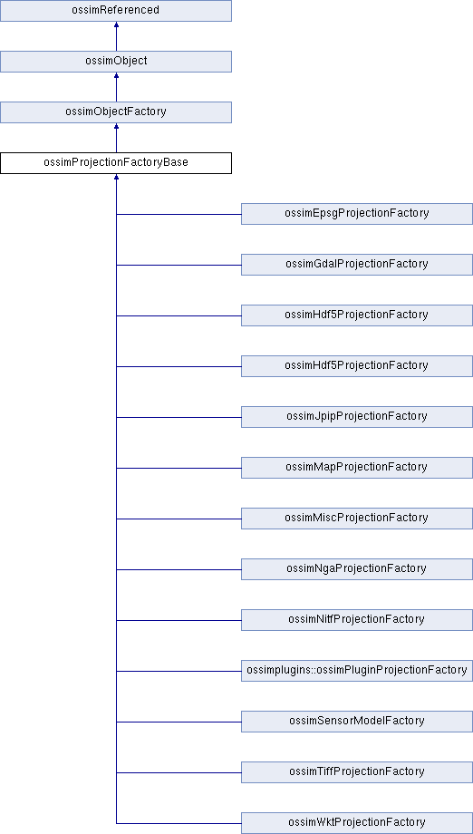

Inheritance diagram for ossimProjectionFactoryBase:
ossimObjectFactory ossimObject ossimReferenced ossimEpsgProjectionFactory ossimGdalProjectionFactory ossimHdf5ProjectionFactory ossimHdf5ProjectionFactory ossimJpipProjectionFactory ossimMapProjectionFactory ossimMiscProjectionFactory ossimNgaProjectionFactory ossimNitfProjectionFactory ossimplugins::ossimPluginProjectionFactory ossimSensorModelFactory ossimTiffProjectionFactory ossimWktProjectionFactory
